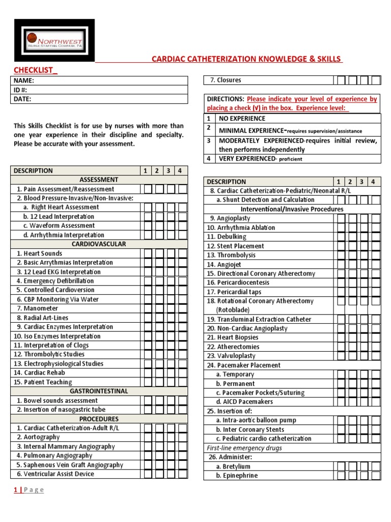

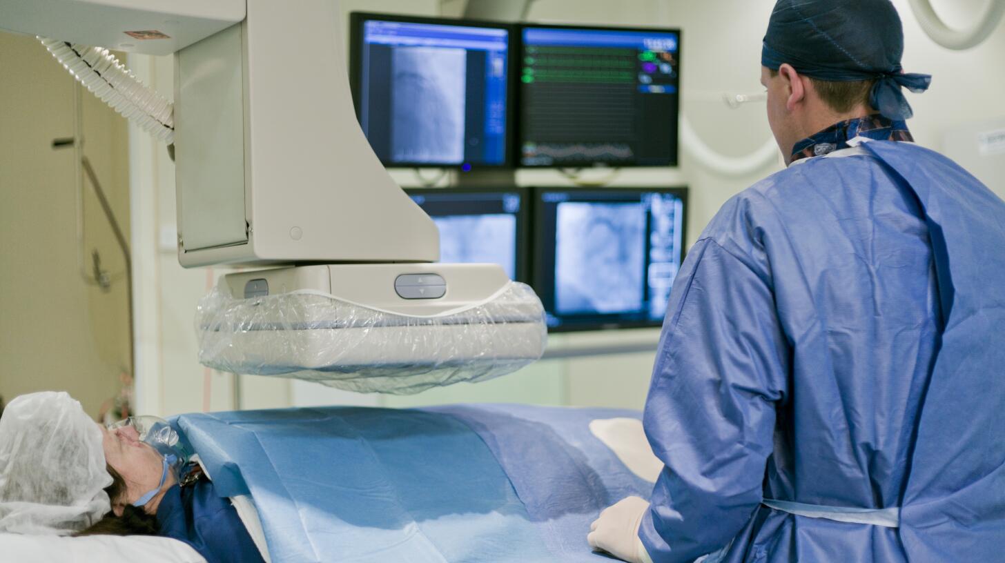

Cardiac Catheterization Ati Template - Web tommy camicia cardiac catheterization procedure. Web study with quizlet and memorize flashcards containing terms like prior to cardiac cath, complications after cath, notify physician and more. A proceedure used to diagnose and treat certain cardiovascular conditions. View an illustration of cardiac catheterization. A thin, hollow tube called a catheter is inserted into a large blood vessel that leads to your heart. Insertion of a long catheter that is threaded through an artery or vein and into the heart. A long thin catheter is inserted into an atery or vein and treaded through that vessel to the heart. A long thin catheter is inserted into an atery or vein and treaded through that vessel to the heart. A proceedure used to diagnose and treat certain cardiovascular conditions. And using catheters to determine blood volume, perfusion, fluid status, how the heart is pumping, and degree of artery blockage.
Care of a client w altered body image ACTIVE LEARNING TEMPLATES
A long thin catheter is inserted into an atery or vein and treaded through that vessel to the heart. Diagnostic for heart diseases, placement of stents, hemodynamic monitoring, heart biopsy, angioplasty, repair heart defects (i. Web cardiac catheterization ati remediation template. A thin, hollow tube called a catheter is inserted into a large blood vessel that leads to your heart..
ATI Diagnostic Cardiac Cath ACTIVE LEARNING TEMPLATES THERAPEUTIC
Using ultrasound to visualize the heart; Web cardiac catheterization (cardiac cath or heart cath) is a procedure to examine how well your heart is working. A long thin catheter is inserted into an atery or vein and treaded through that vessel to the heart. A proceedure used to diagnose and treat certain cardiovascular conditions. Web study with quizlet and memorize.
Cardiac Catheterization ati learning templete ACTIVE LEARNING
Web cardiac catheterization ati remediation template. Web cardiovascular diagnostic procedures evaluate the functioning of the heart by monitoring for enzymes in the blood; Invasive diagnostic procedure used to evaluate the presense and degree of coronary artery blockage. Hole in heart, defective valves, etc) Using ultrasound to visualize the heart;
Cardiac Cath procedure ATI FORM ACTIVE LEARNING TEMPLATES THERAPEUTIC
Determining the heart's response to exercise; A long thin catheter is inserted into an atery or vein and treaded through that vessel to the heart. A thin, hollow tube called a catheter is inserted into a large blood vessel that leads to your heart. Can also be used for remediation after practice quizzes. Invasive diagnostic procedure used to evaluate the.
Cardiac Catheterization Knowledge & Skills Checklist Heart Catheter
View an illustration of cardiac catheterization. Diagnostic for heart diseases, placement of stents, hemodynamic monitoring, heart biopsy, angioplasty, repair heart defects (i. Hole in heart, defective valves, etc) A thin, hollow tube called a catheter is inserted into a large blood vessel that leads to your heart. Invasive diagnostic procedure used to evaluate the presense and degree of coronary artery.
Cardiac Catheterization Lab Director Email List in 2020 Direct
Web study with quizlet and memorize flashcards containing terms like prior to cardiac cath, complications after cath, notify physician and more. Insertion of a long catheter that is threaded through an artery or vein and into the heart. Web cardiac catheterization ati remediation template. Web cardiovascular diagnostic procedures evaluate the functioning of the heart by monitoring for enzymes in the.
CARDIAC CATHETERIZATION Shefaa
Diagnostic for heart diseases, placement of stents, hemodynamic monitoring, heart biopsy, angioplasty, repair heart defects (i. View an illustration of cardiac catheterization. Web routine phyical examination and alterationsof the cardiovascular system such as chestpain, complaints of palpations, alteredmental status (loss of conciousness), andperipheral pain, numbness, and tingling. A thin, hollow tube called a catheter is inserted into a large blood.
Ati Template System Disorder
Web study with quizlet and memorize flashcards containing terms like prior to cardiac cath, complications after cath, notify physician and more. A thin, hollow tube called a catheter is inserted into a large blood vessel that leads to your heart. A long thin catheter is inserted into an atery or vein and treaded through that vessel to the heart. View.
5 Conditions Diagnosed With Cardiac Catheterization
Web study with quizlet and memorize flashcards containing terms like prior to cardiac cath, complications after cath, notify physician and more. And using catheters to determine blood volume, perfusion, fluid status, how the heart is pumping, and degree of artery blockage. Hole in heart, defective valves, etc) Web cardiac catheterization ati remediation template. View an illustration of cardiac catheterization.
ATI Cardiac Catheterization ACTIVE LEARNING TEMPLATES THERAPEUTIC
Web cardiac catheterization (cardiac cath or heart cath) is a procedure to examine how well your heart is working. Diagnostic for heart diseases, placement of stents, hemodynamic monitoring, heart biopsy, angioplasty, repair heart defects (i. Determining the heart's response to exercise; A proceedure used to diagnose and treat certain cardiovascular conditions. Hole in heart, defective valves, etc)
A thin, hollow tube called a catheter is inserted into a large blood vessel that leads to your heart. A long thin catheter is inserted into an atery or vein and treaded through that vessel to the heart. Web tommy camicia cardiac catheterization procedure. Web routine phyical examination and alterationsof the cardiovascular system such as chestpain, complaints of palpations, alteredmental status (loss of conciousness), andperipheral pain, numbness, and tingling. Web study with quizlet and memorize flashcards containing terms like prior to cardiac cath, complications after cath, notify physician and more. A proceedure used to diagnose and treat certain cardiovascular conditions. Can also be used for remediation after practice quizzes. Web cardiovascular diagnostic procedures evaluate the functioning of the heart by monitoring for enzymes in the blood; A proceedure used to diagnose and treat certain cardiovascular conditions. Invasive diagnostic procedure used to evaluate the presense and degree of coronary artery blockage. Insertion of a long catheter that is threaded through an artery or vein and into the heart. A long thin catheter is inserted into an atery or vein and treaded through that vessel to the heart. Hole in heart, defective valves, etc) View an illustration of cardiac catheterization. Using ultrasound to visualize the heart; Web cardiac catheterization ati remediation template. Web cardiac catheterization (cardiac cath or heart cath) is a procedure to examine how well your heart is working. Determining the heart's response to exercise; Diagnostic for heart diseases, placement of stents, hemodynamic monitoring, heart biopsy, angioplasty, repair heart defects (i. Involves insertion of a catheter into femoral, brachial, or radial vessel and.
View An Illustration Of Cardiac Catheterization.
Invasive diagnostic procedure used to evaluate the presense and degree of coronary artery blockage. Using ultrasound to visualize the heart; Insertion of a long catheter that is threaded through an artery or vein and into the heart. A long thin catheter is inserted into an atery or vein and treaded through that vessel to the heart.
Involves Insertion Of A Catheter Into Femoral, Brachial, Or Radial Vessel And.
Determining the heart's response to exercise; Web tommy camicia cardiac catheterization procedure. Web cardiac catheterization ati remediation template. Web cardiovascular diagnostic procedures evaluate the functioning of the heart by monitoring for enzymes in the blood;
A Proceedure Used To Diagnose And Treat Certain Cardiovascular Conditions.
And using catheters to determine blood volume, perfusion, fluid status, how the heart is pumping, and degree of artery blockage. Can also be used for remediation after practice quizzes. A long thin catheter is inserted into an atery or vein and treaded through that vessel to the heart. A proceedure used to diagnose and treat certain cardiovascular conditions.
Diagnostic For Heart Diseases, Placement Of Stents, Hemodynamic Monitoring, Heart Biopsy, Angioplasty, Repair Heart Defects (I.
Web study with quizlet and memorize flashcards containing terms like prior to cardiac cath, complications after cath, notify physician and more. A thin, hollow tube called a catheter is inserted into a large blood vessel that leads to your heart. Hole in heart, defective valves, etc) Web cardiac catheterization (cardiac cath or heart cath) is a procedure to examine how well your heart is working.
