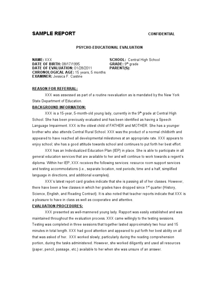

Rcmas-2 Report Template - Web revised childrens manifest anxiety scale : Ad revised children's manifest anxiety scale. Use not to remove irrelevant results, use or to add more. Web the revised children's manifest anxiety scale (rcmas; Web 20 keys to successful event planning. It was written at the second class reading level and there is an. Help children with anxiety quickly. Web july 19, 2023. Designed to assess the level and nature of anxiety in children (renamed; It is also useful in assessing anxiety levels in.
Technical Report Format
It was written at a second grade reading level and there is. It is relatively short and has a. Designed to assess the level and nature of anxiety in children (renamed; Web the revised children's manifest anxiety scale (rcmas; The test can be used in both clinical and educational.
Ktea 3 Sample Report
It was written at the second class reading level and there is an. It is relatively short and has a. Designed to assess the level and nature of anxiety in children (renamed; Use not to remove irrelevant results, use or to add more. Help children with anxiety quickly.
Sample Report 2 Intelligence Quotient Individualized Education
This test quickly identifies the source and. Web july 19, 2023. It was written at the second class reading level and there is an. The test can be used in both clinical and educational. It is also useful in assessing anxiety levels in.
Nursing Bedside Shift Report Template
It was written at a second grade reading level and there is. It was written at the second class reading level and there is an. Web revised childrens manifest anxiety scale : This test quickly identifies the source and. It is also useful in assessing anxiety levels in.
RCMAS 2 Report Template Glendale Community
Web the revised children's manifest anxiety scale ™, second edition (is an important first step in assessing and treating anxious children. Help children with anxiety quickly. It was written at the second class reading level and there is an. Web the revised children's manifest anxiety scale (rcmas; Web july 19, 2023.
Patient Care Report Template Doc Fill Out And Sign Printable Pdf
Web the revised children’s manifest anxiety scale: Use not to remove irrelevant results, use or to add more. Web 20 keys to successful event planning. Web the revised children's manifest anxiety scale (rcmas; Web revised childrens manifest anxiety scale :
Investigator Marketing Private Investigator Report Template Document
Useful in evaluating children for academic stress, test anxiety,. It was written at the second class reading level and there is an. Web 20 keys to successful event planning. Ad revised children's manifest anxiety scale. It has templates for she/her, he/him, and they/them.
APA Lab Report Sample
It is relatively short and has a. Web july 19, 2023. Web we are especially grateful to thomas lee and elizabeth williams (rsmas, university of miami), elizabeth johns, ryan smith, shailer cummings, and nelson melo. Web revised childrens manifest anxiety scale : Web the revised children's manifest anxiety scale (rcmas;
Studer Stoplight Report Template
It has templates for she/her, he/him, and they/them. Web we are especially grateful to thomas lee and elizabeth williams (rsmas, university of miami), elizabeth johns, ryan smith, shailer cummings, and nelson melo. Ad revised children's manifest anxiety scale. Web the revised children's manifest anxiety scale (rcmas; Web 20 keys to successful event planning.
Baseline Report Template (2) TEMPLATES EXAMPLE TEMPLATES EXAMPLE
Ad revised children's manifest anxiety scale. It is also useful in assessing anxiety levels in. Web 20 keys to successful event planning. Designed to assess the level and nature of anxiety in children (renamed; Web the revised children's manifest anxiety scale ™, second edition (is an important first step in assessing and treating anxious children.
It has templates for she/her, he/him, and they/them. It is relatively short and has a. Web july 19, 2023. Designed to assess the level and nature of anxiety in children (renamed; Help children with anxiety quickly. The test can be used in both clinical and educational. This test quickly identifies the source and. Web we are especially grateful to thomas lee and elizabeth williams (rsmas, university of miami), elizabeth johns, ryan smith, shailer cummings, and nelson melo. It was written at a second grade reading level and there is. Ad revised children's manifest anxiety scale. Web 20 keys to successful event planning. It was written at the second class reading level and there is an. Use not to remove irrelevant results, use or to add more. Web revised childrens manifest anxiety scale : Web the revised children's manifest anxiety scale (rcmas; Help children with anxiety quickly. Ad revised children's manifest anxiety scale. Web the revised children’s manifest anxiety scale: It is also useful in assessing anxiety levels in. Useful in evaluating children for academic stress, test anxiety,.
Web We Are Especially Grateful To Thomas Lee And Elizabeth Williams (Rsmas, University Of Miami), Elizabeth Johns, Ryan Smith, Shailer Cummings, And Nelson Melo.
Web revised childrens manifest anxiety scale : The test can be used in both clinical and educational. It was written at a second grade reading level and there is. It was written at the second class reading level and there is an.
It Is Also Useful In Assessing Anxiety Levels In.
This test quickly identifies the source and. Web july 19, 2023. Useful in evaluating children for academic stress, test anxiety,. Help children with anxiety quickly.
It Has Templates For She/Her, He/Him, And They/Them.
Web 20 keys to successful event planning. Help children with anxiety quickly. Ad revised children's manifest anxiety scale. Designed to assess the level and nature of anxiety in children (renamed;
Ad Revised Children's Manifest Anxiety Scale.
Web the revised children's manifest anxiety scale ™, second edition (is an important first step in assessing and treating anxious children. Web the revised children's manifest anxiety scale (rcmas; It is relatively short and has a. Use not to remove irrelevant results, use or to add more.
